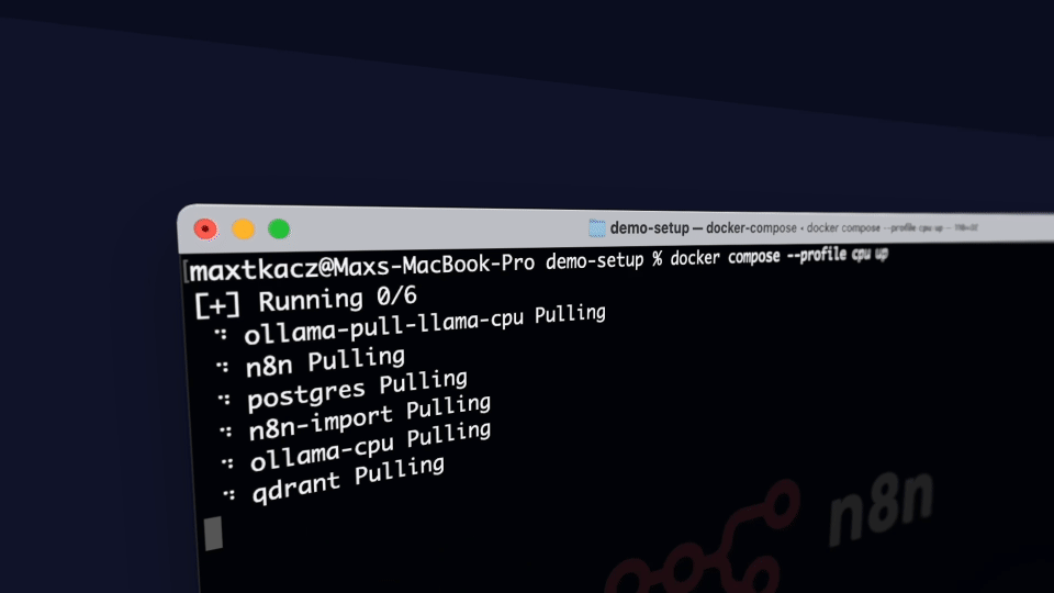

The project includes a start_services.py script that handles starting both the Supabase and local AI services. The script accepts a --profile flag to specify which GPU configuration to use.
For Nvidia GPU users
python start_services.py --profile gpu-nvidia
Note
If you have not used your Nvidia GPU with Docker before, please follow the Ollama Docker instructions.
For AMD GPU users on Linux
python start_services.py --profile gpu-amd
For Mac / Apple Silicon users
If you're using a Mac with an M1 or newer processor, you can't expose your GPU to the Docker instance, unfortunately. There are two options in this case:
  1. Run the starter kit fully on CPU:
    python start_services.py --profile cpu
  2. Run Ollama on your Mac for faster inference, and connect to that from the n8n instance:
    python start_services.py --profile none
    If you want to run Ollama on your mac, check the Ollama homepage for installation instructions.
For Mac users running OLLAMA locally
If you're running OLLAMA locally on your Mac (not in Docker), you need to modify the OLLAMA_HOST environment variable in the n8n service configuration. Update the x-n8n section in your Docker Compose file as follows:
x-n8n: &service-n8n
  # ... other configurations ...
  environment:
    # ... other environment variables ...
    - OLLAMA_HOST=host.docker.internal:11434
Additionally, after you see "Editor is now accessible via: http://localhost:5678/":
  1. Head to http://localhost:5678/home/credentials
  2. Click on "Local Ollama service"
  3. Change the base URL to "http://host.docker.internal:11434/"
For everyone else
